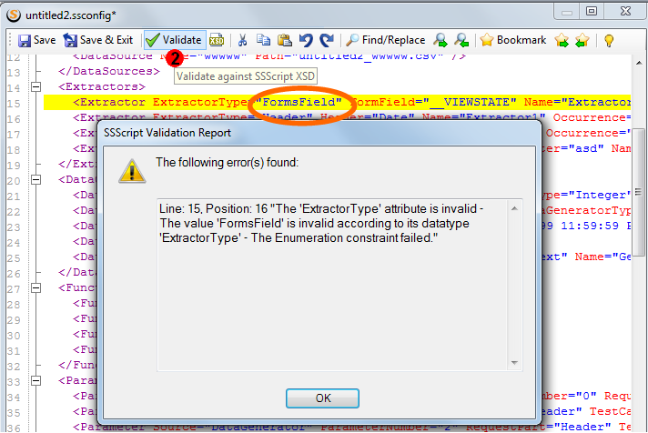

2. Script format and content validation. When a script is saved or when a user clicks validate, SSScript is validated against XSD to verify its formatting and content. Detailed diagnostic helps to correct errors quickly.
![](/blog/ng-images/5A7A23A79C7BD66133B7A689651B41DC.png)

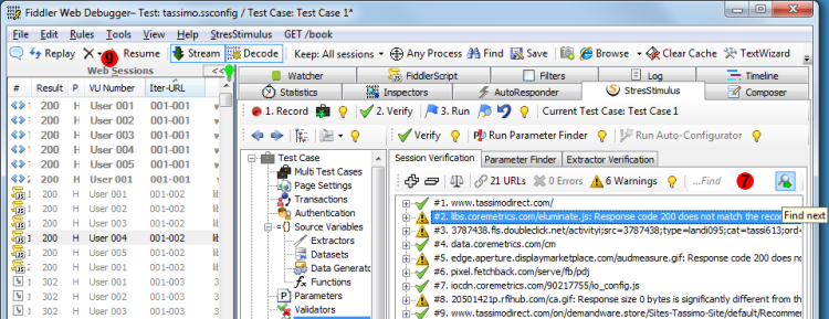

9. In the fiddler grid added “VU Number” column to display virtual user number.
![](/blog/ng-images/23659835003A11635FF029FBCFDA00FD.png)
