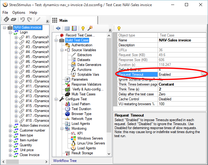

How to configure them: You can disable timeouts under Build Test Case settings.

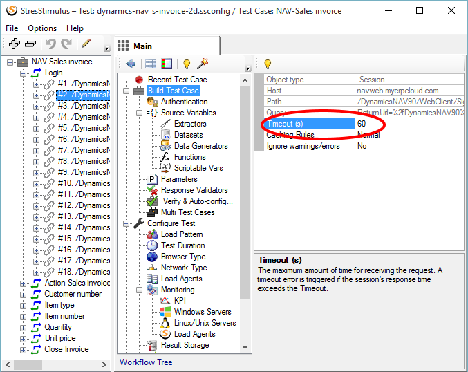

Timeouts work on the request level, not on the page level. The timeout threshold can be changed for every page (see below), and this value will be imposed on every request of the page. In v4.5 the default timeout threshold is 60 seconds.

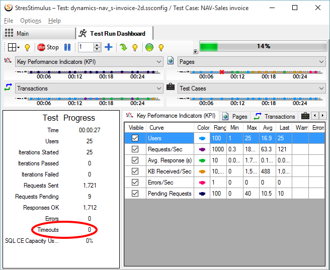

How they are tracked and reported: Every timeout is tracked in real time and is reported on the graph and the progress bar. At the end of the test, the number of the timeouts is reported for every request and every page. The page is considered timed out when at least one of its requests is timed out. StresStimulus treats timeouts somewhat similar to the errors. Timed out sessions are displayed in the grid in red, even though the response status code can be 200. Timed out response bodies by default are not purged to simplify troubleshooting. Unlike regular requests that have request and response events, the timeout requests additionally have a timeout event between those two. The responses of timed out requests completed during the test are counted toward the test metrics (average response time and size).
Changing the timeout threshold may impact the number of timeouts in the test report. If this seems to be confusing, remember that the timeout mechanism is only necessary to allow the test to continue or complete sooner. You should not translate the number of timeouts in the load test to a real world user experience, since there are no timeouts in the real world. If the number of timeouts is relatively high, it can impact the accuracy of your test results. In this case I recommend a few options:
