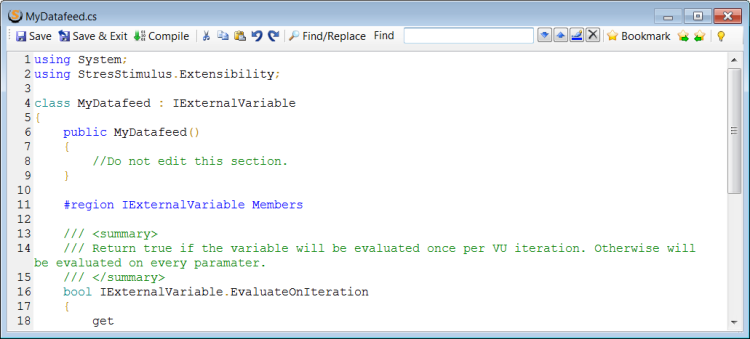

2. Internal scripting capabilities. Now you can create Extensibility objects without any additional developmental tools. You can write your code directly in StresStimulus. ![](/blog/ng-images/E4DAB73DE75116893C85FCAF658CFA90.png)
![](/blog/ng-images/CB294EBAED2F760A958C64BECD7C52CA.png)

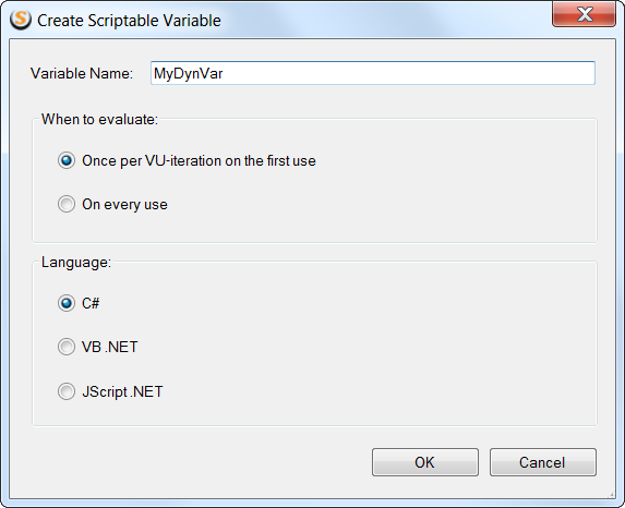

3. Support for three programming languages. You can write your extensibility code in one of the three languages: C#, VB.NET or JScript.NET. ![](/blog/ng-images/E4DAB73DE75116893C85FCAF658CFA90.png)
![](/blog/ng-images/9EF98916FF2E1226857D4C41DF62399B.png)
