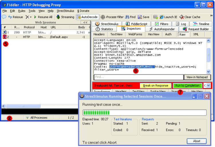

5.Fiddler will start capturing the original test case sessions, will pause before sending the desired sessions and mark them with the red icon.
6.Select each paused session and make necessary changes using Raw or WebForms inspector. You can change URL, remove a cookie or make any other change.
7.Click green button “Run to completion”, so Fiddler will continue capturing the modified sessions.
