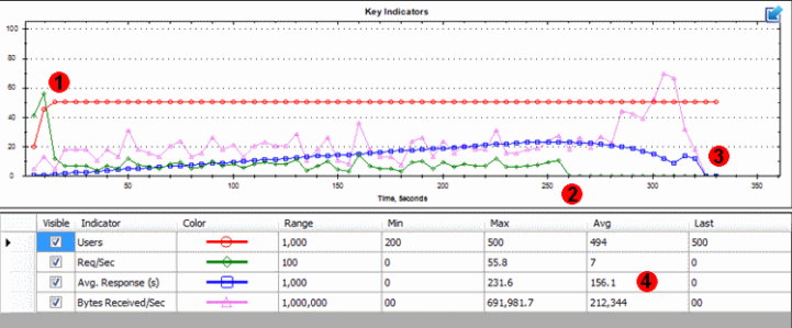

Hi Lakmal,
It looks like your test stopped.  It  was set to run for 500 sec, but you aborted it in > 2692 seconds.   The issue with stopping the progress bar was fixed in the hot fix that we released yesterday (see this post). It may be the same one that you are having, so please try the fix until the next (official) beta release is out. The hot fix can be downloaded here.
5/13/2011
Lakmal,
My previous comment was about the test which you’ve pasted. I missed the attachment.
Here is my response about the test in the attachment (below I pasted your Key Indicators graph):
The test was set to run 250 seconds and after that wait for pending responses. It ramped up to 500 users in the first ~10 seconds (1). Then at ~ 250 s it stopped sending requests (2) and was waiting for another ~82 s to receive all pending responses (3). Test completed successfully in 332 seconds. All 2304 requests were returned by the server without errors. However, the average response time was 156.1 s (4), which is unacceptably high.
Note: The current version of StresStimulus does not track long response time as errors. Base on your input, in the next version we will add page timeout tracking.
Below are the answers to your questions:
Q:“So what could be reasons for this? Is the application give error message when web application is crashing?”.
A: What makes you believe that there are errors or crashing? I do not see any errors in the attachment. Your server/application is slow.  The average response time (blue graph) grew  during the first 10 s due to users ramping.  It continued to grow throughout the test  (with constant 500 users) because of growing server request queue.
Q:”What do you think would be good configuration for my requirements.”
A: To troubleshoot the performance you should use more granular user ramping. I suggest starting with 10 users and incrementing by 10 users every 10 seconds. Watch at what load level the response time reaches unacceptable level.

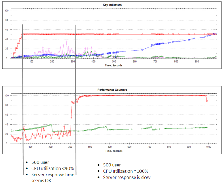

Today I ran load test for another web application and got the below results.
Again I did see abnormal behavior. According to results of our web application, it should be slow with 500 Vuser load.
While running the load test in one machine, I connected to same web application using other machine. At that time response time was around 500 seconds. That means it takes around 8 minutes for a request. At that peak time I logged from another machine to a same web application (while running the load test) and I expected to see extremely slow response because load test is already running.
But I saw application is running properly without any delay. So I’m confused with accuracy of the tool.
I think when another user login from another machine he should experienced the slow reponse.But it is not happening.
Please explain this. see attached document.

6/24/2011
Hi Lakmal.
The problem with this test is that your client got overloaded, with CPU Utilization reaching 100% after about 350s after test started. Load test only OK if the client CPU utilization stays below 90%. This is a general rule of thumb,  not specific to StresStimulus. This post explains how running load test on overloaded client  gives wrong result:  The "request response time" measurement.
When you reached 500 users, between 50 and 350 sec, but CPU utilization stayed low, the response time seems to be good. It increases after  reaching 100% CPU utilization. I assume that the red line on the Peformance Counters graph is CPU utilization (default).
Couple if suggestions to address this issue:
  1.  Restart Fiddler to make sure that there is no issue with its process.
  2. Make sure that in the StresStimulus main menu -> Options -> Purge response bodies set to All or Non-Errors.
  3. See if you can close any programs that uses resources on this machine.
  4. If none of these steps will help, you may need to reduce the number of virtual users or split them between several machines.
