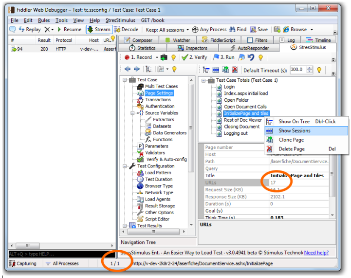

One correction: in the Page Settings node the URLs property of the Page displays the total number of requests, not the number of performance impacting requests. We are adding this property in v3.0.
Excellent, this is what I thought it did. However, I'm still unsure whether or not my requests are counted as Performance Impacting.
Currently, you can determine the number of page performance impacting requests by selecting "show sessions".
While your page in question has 17 requests, only the 1-st is counted by StresStimulus as performance impacting.

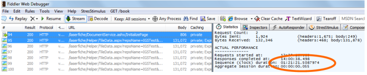

StresStimulus uses a heuristic algorithm to determine non-performance impacting requests. In this case, StresStimulus determined that sessions 2-17 on this page are ajax requests because request 2 was issued about 1 hour after the response 1 was received.  To determine this, I selected first two requests of this page in fiddler and statistics shows that sequence (clock) duration is 1 hour and 20 minutes. It looks like you added requests 2-17 to this test case after it was recorded and therefore their timers are off from the timers of other test case requests.
