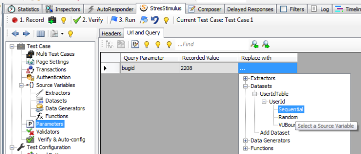

You need to create (a) a dataset and (b) a corresponding parameter, as follows:
a). Create a dataset,  (e.g. UserIDTable) with a single column (e.g. UserID).
b) Click the Parameters node. Then select the Url and Query tab. Find the UserId query parameter and set its Replace With value to the dataset, as shown below

After you parameterized this request with the dataset, it became dynamic. So, every VU will issue this request with a different parameter value from the dataset.
After the test is complete, the Request Details grid combines all replayed instances of this request to aggregate its performance metrics. Such metrics are reported on a single line that is identified with the recorded URL which in your case will be "… userID 124…". This is normal.
