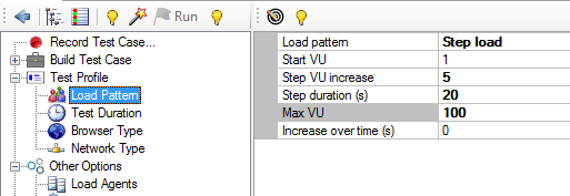

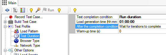

I am trying to achieve is to run the test cases, in a loop or say continuously for say ‘X’ hours. What is the best way to set that up. I tried with 100 VU and set it to run for 1 hour. It finished creating 100 records in less than 10 minutes and I am not quite sure what it was doing for the rest of the 50 minutes. It did not create any records after the 100. I was expecting that it continues to create the records for an hour. Maybe the settings that I am trying is incorrect.
9/1/2023
Your test profile setup is correct. Each created VU will execute the test case multiple times until the test ends.
According to your description, it sounds like every VU creates one record on the first iteration and fails on subsequent iterations. The most likely reason for that is your test case is misconfigured.
I suggest running Verify with 2 iterations as described https://support.stresstimulus.com/display/doc58/Verifying+the+Test+Case and then fixing any script errors as described https://support.stresstimulus.com/display/doc58/Resolving+Errors+and+Warnings
