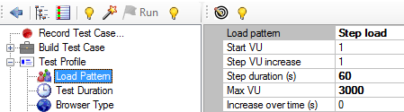

If you need a specific ramp-down then you will need a custom load pattern that is described https://support.stresstimulus.com/display/doc53/Custom+Load.
However, I suggest doing a step load ( https://support.stresstimulus.com/display/doc53/Step+Load

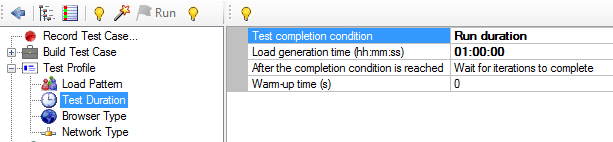

Then set the Test duration to Run duration for 60 minutes and Wait for iterations to complete. This will force all VUs finish their current iteration after 60 minutes and do a natural ramp down.
