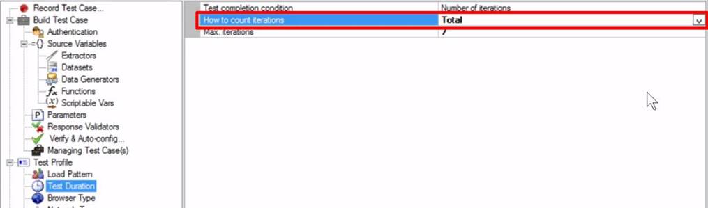

  • In our recent performance tests we have set “How to count iterations” to “Per VU”. This has shown the VUs, picking unique data from the dataset with each iteration.
  • However, we recently changed the setting to the below. In theory, we assumed by choosing this option we wouldn’t need to calculate the number of “Max Iterations” per VU. Because we would simply enter the total number of iterations the all vusers should complete.
  • What we discovered when selecting this option is the first 15 VUs would select unique rows data from the dataset, however, after that point the next VU seemed to pick the first row from the dataset. This caused duplicate orders to be created with the same subject details.
  • By the end of test this setting achieved the goal of completed the Max Iterations set. However, during the process it ended up creating duplicate orders.

I am assuming you are using VU-Iteration-Bound binding for your dataset. The formula that calculates which record will be used (https://support.stresstimulus.com/display/doc53/Databinding ) is
Record Row number = (Iteration #) * (Max VUs) + (VU #)
When you set the How to count iterations property to Total, you do not guarantee that every iteration will get an equal number of iterations. If VU1 executes ten iterations, then on the 10th iteration, it will use the 301-st record, but since you only have 210 records, the scripts will re-use the top records.

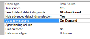

I suggest setting the VU-to-row mapping to On-Demand described https://support.stresstimulus.com/display/doc53/Default+databinding and try rerunning the test.`
