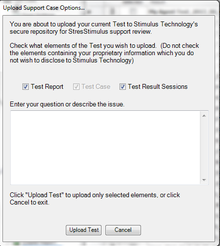

  1. The test results were missing in all uploads. Since you switched from an external SQL Server to SQL CE, the only other explanation to this happening is that you did not check the "test result sessions" in the upload support case options.
