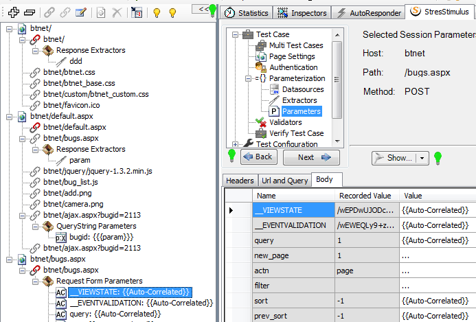

Asp.net view state is retained by default, right? I don't have to do anything special to be able to test Asp.net sites that rely heavily on view state, is that correct?
10/10/2012
Correct . StresStimulus automatically auto-correlates ViewState and many other dynamic parameters. To determine which parameters of a request are auto-correlated, select the request in Fiddler, and the grid in the Parameters section will indicate that (as shown below).
