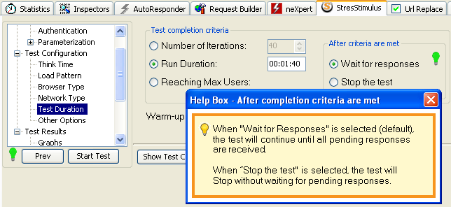

I ran a test with timeouts set to the 120s and I got timeouts even though the test duration was set to 1min 40sec.  How is this possible?
9/21/2011
What was the real test duration (in the summary report check “Test run duration”)?  It can exceed the test duration set in the “Test Configuration” if you selected “Wait for responses”. In your case, once StresStimulus reached the 100s mark, it will stop sending new requests; however the test will not stop until all pending responses are received.
If you select “Stop the test” instead, then the test will stop at exactly the 100s mark and you will not receive timeouts.
