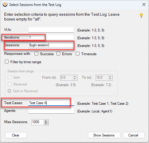

To check that StresStimulus uses a different row for every VU, do the following steps:
1. Determine the login session (request) # in Test Case A and in Test Case B
2. In the report, open the Session Test Log (https://support.stresstimulus.com/display/doc57/Querying+the+Test+Log) and query the login session number above for the first iteration and for Test Case A and then for Test Case B
1. Open each resulting session and check the credentials row that was used.
If a different credential row was used in every request, you might be dealing with a concurrency issue rather than a duplicate row issue.
