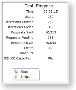

One of the reasons that a test can seemingly stop at a certain point is server inability to keep up with sending timely responses. Here's how it works. Virtual users, like physical browsers, send subsequent requests after receiving responses back from the server. Once the number of pending requests exceeds certain level (specific to the emulated browser) the VU will wait until the responses are received, or a timeout occurred.
To check if this is the case in your situation, look at the Requests Pending counter in the Test Progress Panel described here http://support.stresstimulus.com/display/doc42/Monitoring+the+Test and shown below:
If this counter does not decrement, then the server is slow to respond. In this is the case, you have a few options.

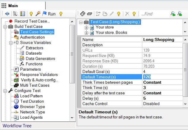

1.    Reduce the number of VUs so your server and can keep up with the amount of load from StresStimulus.
2.     Reduce the default page timeout value located in the Workflow Tree-> Test Case Settings. The default value is 120 seconds. It is described here:
http://support.stresstimulus.com/display/doc42/Page+Timeout

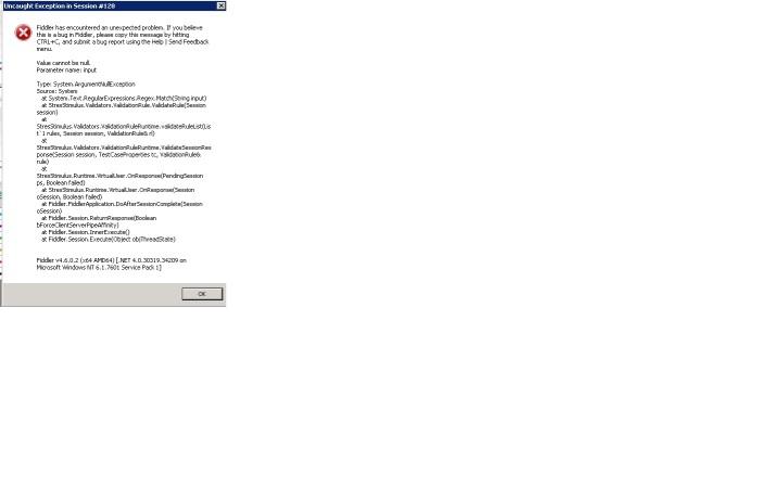

Thanks for the response. I have dubug this problem little bit more. I tried to execute this test using fiddller and found that after 15% completion it through one exception. Screenshot of the exception is also attached here. After this i tried to record new script and execute it it works fine. Then i have added respons validator in 2-3 requests and again the same problem started coming. So i think this problem is something related to response validator. Can you please help me in this.

Vivek,
Thanks for your detailed update. You're right that the exception was thrown by the validators. It was possibly caused by applying a validator to an empty or corrupt response body.
We fixed the issue .  The fix will be included it in the next StresStimulus build after a complete regression testing cycle.
In the meantime, we issued a hotfix that is available here
http://update.stimulustechnology.com/stresstimulus/StresStimulusInstaller_fix.exe
 Let me know how it goes.
