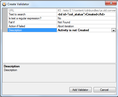

This requirement can be implemented with response validator described here http://support.stresstimulus.com/display/doc51/Response+Validators
You do not need an extractor for that. Create a response validator with the following properties:
• Set Text to search to a pattern for searching “Created” in the status column. For example, <td id=”col_status”>Created</td>
• Set Fail If to Not Found
• Set Action if failed to Abort or Continue
• Set Description to Activity is not Created
An error will be generated if the status is not "Created”. The error “Activity is not Created” will be in the report in the error section.
