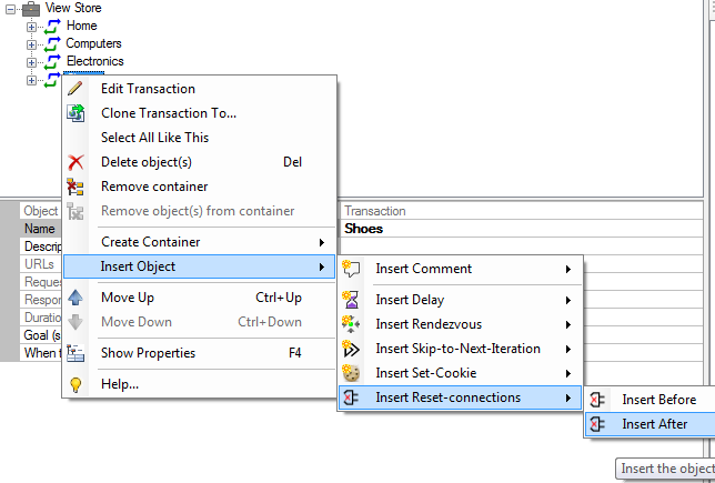

It sounds like now you need to change a single VU’s server authentication credentials on different iteration.
In server authentication, the credentials are stored on the connections level, so you would need to close the connection and reopen it with new credentials on every next iteration.
It can be accomplished by using a Reset Connection object (described http://support.stresstimulus.com/display/doc53/Reset+connections)
First, you would need to add the Reset-connections object to the very end of your test case.

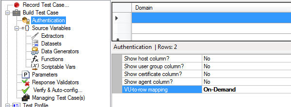

Then in your Authentication section set the VU-to-Row mapping = On-Demand
