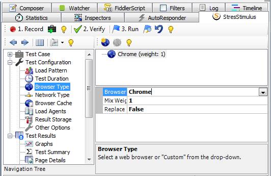

I want run my tests in Chrome, but there is no such option in StresStimulus.
Please give any suggestions.
3/5/2013
While running a test, StresStimulus can emulate all major browsers including Chrome. To configure it, in the Test Configuration section -> Browser Type, select Chrome.
