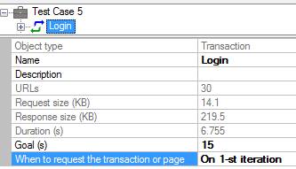

  • You can login, only on the first iteration. To do this, set the When to request the page or transaction property to On 1-st iteration as described http://support.stresstimulus.com/display/doc53/When+to+Request+the+Page

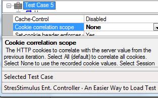

  • 2. Another suggestion is to clear cookies from the previous iteration. In StresStimulus you can clear the cookies from the previous iteration by setting Cookie correlation scope property to None as described http://support.stresstimulus.com/display/doc53/Cookie+correlation
