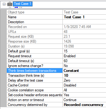

Ran a sanity test with 2 users and 2 iterations for each. But, the test took almost 7min to complete though the response times were within 5 seconds. Would like to know why it took so long?
10/12/2021
The most likely reason is that you have high think time ( https://support.stresstimulus.com/display/doc53/Think+Time). By default, the think time between transactions is 10 seconds. The transaction times you see on the report do not include think times.
