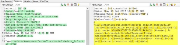

I am getting an error validating a test that previously ran without issue. The first error I’m seeing is below. Any idea what could be causing this? I am able to run other tests just fine.
1/25/2018
The error message suggests that the re-mapped host is unreachable from your StresStimulus machine. This can happen when the host is down or DNS resolution to this host does not work.
To troubleshoot it, try accessing it from a browser on the StresStimulus machine.
