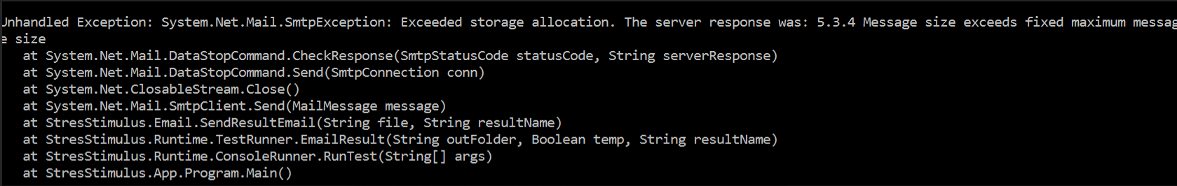

The reason I run the commandline test via the UI is because when I run it via the /noui parameter the sending of the email report which works fine via the UI fails with this exception on test completion:
Any idea why sending the test report via the UI works fine but running the same test via noui would return this error?

As far as your question on why email is not sending when running a test with /noui flag, the error message states that the SMTP server cannot send the email because of its size. I suggest looking at the SMPT server logs for complete details.
