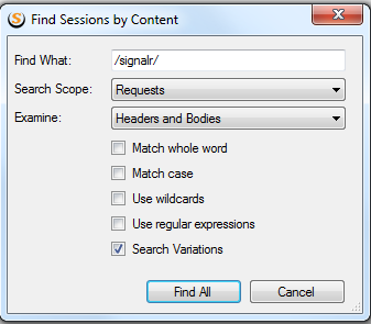

However, it should be even easier to delete SignalR requests as the impact to test accuracy would be negligible. To do so:
1. Bring up Find Sessions by Content dialog by hitting Ctrl+F
2. In the Find What textbox type: /signalr/ and set search scope to Requests
3. Click Find All button
4. Click Delete the found highlighted sessions button to delete all SignalR requests
