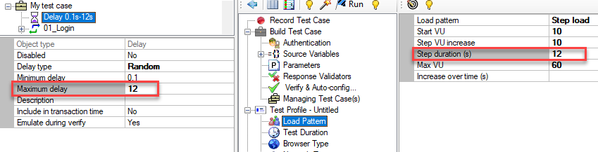

I would suggest inserting a Delay object https://support.stresstimulus.com/display/doc58/Delay before the login transaction with the following properties:
· Set the Delay type property to Random
· Set the Maximum delay property equal to the Step duration property in the Step load pattern (see screenshot below). That way, the VUs logins will be spaced out to their maximum extent.
