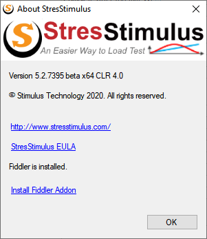

The Client Certificate feature in the latest beta version (v5.2.7395) is still not working.
Here is a screenshot of the version

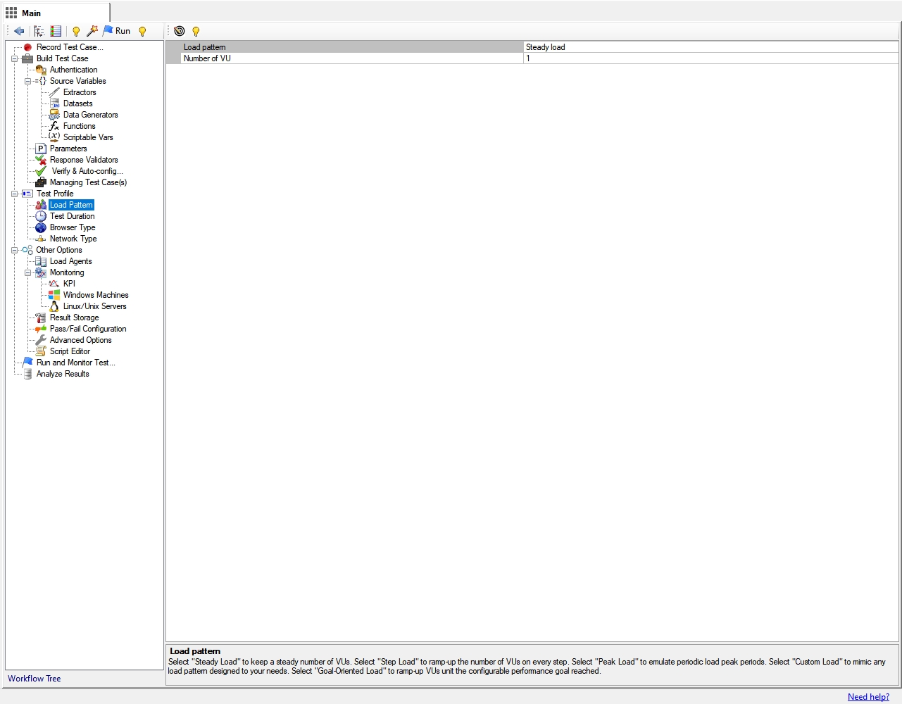

Here is the Load Pattern view

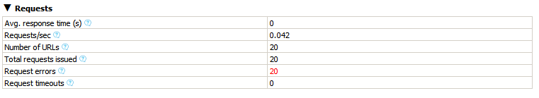

Here is the screenshot showing that out of the 20 requests, all 20 requests failed
Thank you.
