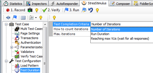

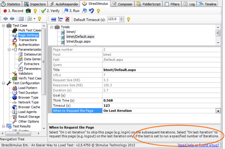

I double checked that the "On Last iteration" feature seems to work as designed. When "Test Duration" is set to "Number of Iterations ",
then pages marked "On Last iteration" (eg. log-off), run once, as specified in the application help.
However, when "Test Duration" is set to "Run Duration", then the log-off pages do not run at all, since StresStimulus completes the test after certain time elapsed and does not have a chance to run logoff pages for every user.

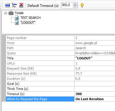

Hi Vadim!
I made one more test with this - see attached test file. I still have same effect - it seams that second request is still run on every (2) iteration:
And there, how it is configured:

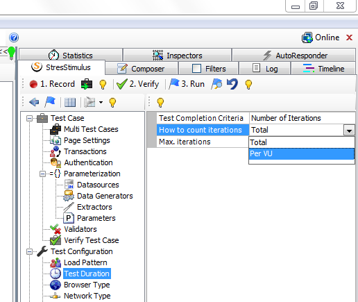

Bartek,
Got it and found the issue with the test configuration.
For "On Last iteration" to work correctly, the "Number of iterations" settings should be set "per VU". So, instead of setting 80 combined iterations for two VUs, set 40 iterations per VU. In the first case, the 80 iterations will be divided between users not necessarily evenly, because the faster VU will run more iterations. As a consequence of this, StresStimulus cannot determine the last iteration for each VU.
In the next release will add a warning to guide users to a correct configuration.
