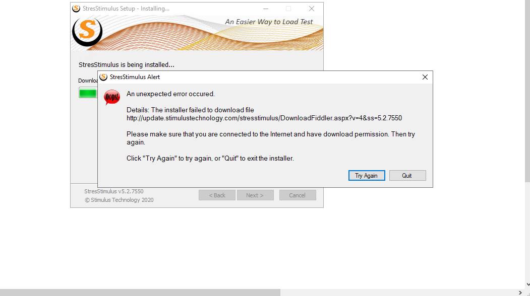

We are looking for a offline installer as our first attempt shown below indicates the install requires the server to have outbound internet access. Currently this server does not access to the internet.

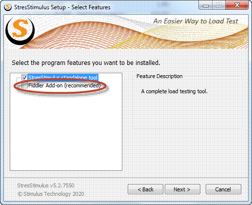

Since the computer you are installing StresStimulus on doesn’t have internet access, you need to uncheck the Fiddler Add-on checkbox, as shown below.
If you need to have Fiddler installed on that computer, then follow these steps:
  • Download it from Fiddler website from https://www.telerik.com/download/fiddler
  • Install it manually.
  • Reinstall StresStimulus with the Fiddler add-on option checked
