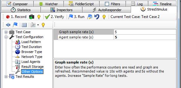

I ran a simple test, but the saved report does not contain a graph.
3/8/2013
By default, the graph sample rate is 5 seconds, so tests shorter than that time will have no dots plotted on the graph. If this is the case, decrease the sample rate or increase the duration of your test.
