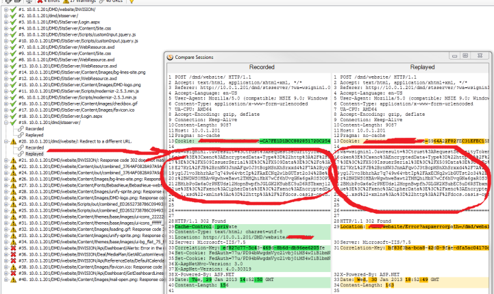

Hi Vadim ,
After our session the other day I am still running into the issue. a freshly recorded script will work for a day  and then will start failing the next day .. I also sent a request to 'support@stimulustechnology.com' on the same.
I was able to trackdown the reason to a security token that needs to be passed from a prior request to a subsequent request .. However am unclear on how to do this thru stress stimulus.
Attached a screen shot below note that the circled payload needs to be extracted from before request
Microsoft.IdentityModel.Tokens.SecurityTokenExpiredException: ID4223: The SamlSecurityToken is rejected because the SamlAssertion.NotOnOrAfter condition is not satisfied. NotOnOrAfter: '1/29/2013 3:51:50 PM' Current time: '1/30/2013 6:33:41 PM'
1/31/2013
Hi Sundara,
There is a possibility that your server application denies request with expired parameters, so using dynamic parameters instead of recorded values very well may fix it.
Generally, to parameterize a parameter (a security token, in this case) you need to create a corresponding extractor in the previous response, and then parameterize the parameter in the request by replacing the recorded value with the extractor.
In the screenshot, you circled multiple name / value pairs, so I’m not sure if you want to parameterize all of them, or some of them, so I’ll give a general direction.
To learn how to create an extractors check this post http://www.stresstimulus.com/blog/post/v2-5-update-3
Then, to create a body parameter:
  1. Select Parameter or Navigation Tree.
  2. Select the request on Test Case Tree.
  3. Select the Body tab.
  4. Click in the “Replace with” cell on  the parameter row. Parameterization Control will appear. Expand the Extractors node and select the extractor that you created.
 Depending on your request type, the “Body” tab may look differently, but the concept is the same.
Does this make sense?

1/31/2013
Sundara J
Sundara J
Posts: 11
thanks much that worked ..
