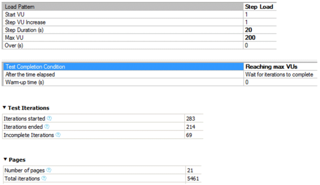

My load pattern, shown below, is at a max of 200 VUs, but I see total iterations for the pages at over 5400. Do my settings mean that the VU will repeat the same pattern of requests until 200 users are running concurrently?
3/3/2015

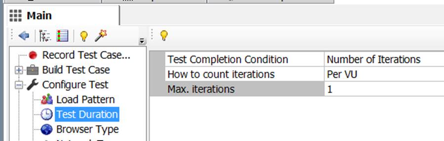

Yes, you are correct. In your configuration, each VU will keep repeating the same pattern (iteration) until the test completion condition is met, which is reaching Max VUs.
If you want to limit the number of iterations for every VU, set the Test Completion Condition to “Number of Iterations” and set the Max. iterations value to the number of iterations each VU should execute. For 1 iteration per VU, set it to 1 (see screenshot below).
For more information on Test Duration check this page http://support.stresstimulus.com/display/doc40/Test-Duration.
