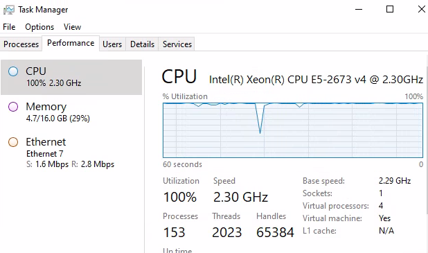

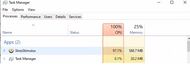

We are running load test with 1000vu in our project. We used 4 load generators. CPU on LG machines is going to 100% when the user load reaches ~150 on Load generator.
I have verified the LGs before starting the test. CPU on all machines is less than 3 percent.
During the test, only Stresstimulus process is taking ~98 percent cpu.

The most common cause of high CPU utilization is test case configuration. Here are a few suggestions you can try:
  • Make sure you configured a realistic think-time (https://support.stresstimulus.com/display/doc58/Think+Time). It typically should be what It takes for an average user to look at a page and make their next click. Selecting a too-low think-time can cause inaccurate performance test results.
  • Make sure you have enabled the client execution delays, representing client-side page rendering time and script execution time (https://support.stresstimulus.com/display/doc58/Client+execution+delays)
  • If you have multiple test cases, one of them may use CPU cycles the most. You may execute your test with various combinations of the test cases to single out a test case causing high CPU utilization and troubleshoot it separately.
For more targeted troubleshooting, additional details would required that you can discuss with your support rep.
