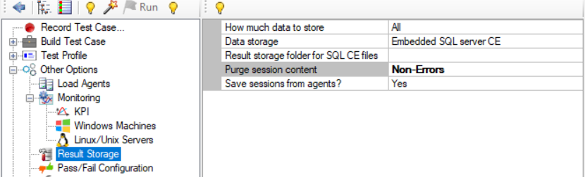

We faced the following issue: "Test data reached the maximum capacity allowed for SQL CE storage or you ran out of disk space". The test will stop. while executing a 50Vusers Load test with Stress Stimulus.
Can you please provide assistance in resolving the issue mentioned below. (refer to the attached snapshot).
Also please let us know the reason for this issue, and how we can prevent it for the load tests executed in future?
9/11/2020
By default, StresStimulus logs the content of all requests and responses in the test SQL CE embedded database log that has a capacity limit of 4GB per test run. For long tests with scenarios that have high payload HTTP messages, the default settings should be modified.
To avoid the maximum capacity issue when your local SQL CE database reached its 4GB capacity as described http://support.stresstimulus.com/display/doc52/Reducing+Test+Storage+Use
it is recommended to make the following configuration change:
Reduce test storage use by logging the request/response bodies of sessions with errors only. In the Result Storage section, set the Purge session content to Non-Errors.
For very large and long tests, you can further increase storage capacity by removing the 4 GB limit per test run. To do so, you would need to switch to your full SQL Server for the test repository that is only limited by the amount of available disk space. It can be configured in a few mouse clicks as described here http://support.stresstimulus.com/display/doc52/Test+Result+Storage
With these options, you can run tests of any length you need.
