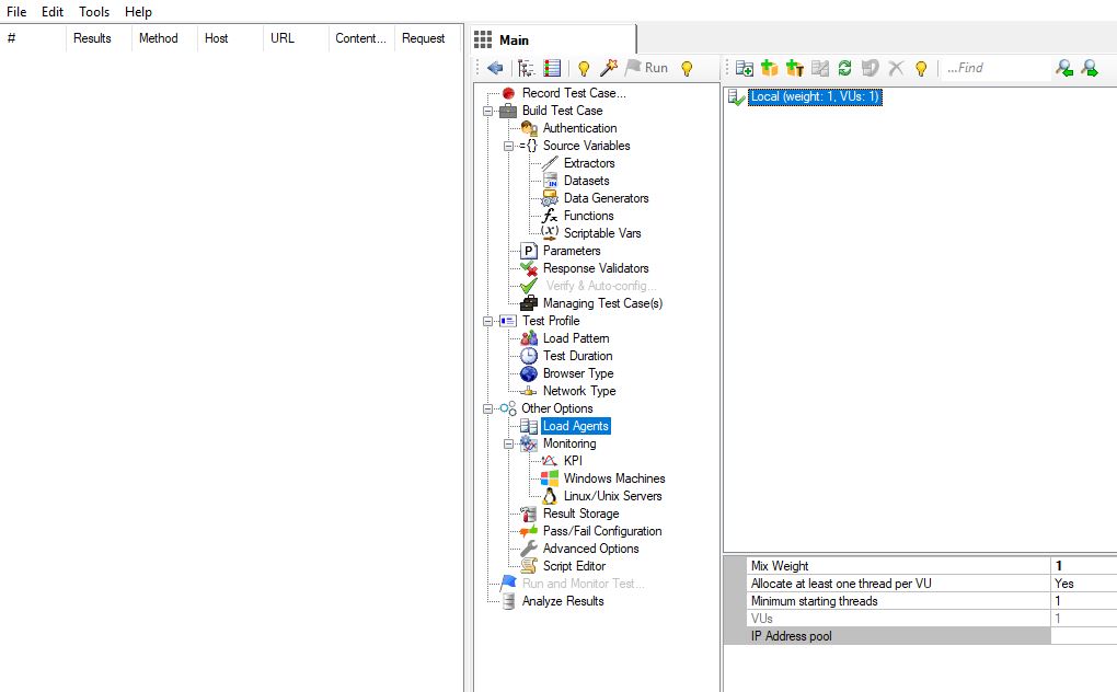

I tried to add agent same as steps mentioned here:
http://support.stresstimulus.com/display/doc50/Attaching+Agents+to+Controller
but while saving I got error Agent mode should be enables
then I enabled it from Agent Options but after that I was not able to user stresstimulus tool, record and run options are disabled.
what should I do , I attached also the steps in sequence.

The behavior is by design. After installation, StresStimulus works as a controller.
After enabling agent mode, it works as a load agent whose purpose is to communicate with another controller and generated load. It cannot be used to record or modify the script or perform any other tasks. To do so, you need to disable agent mode, so StresStimulus becomes a controller again.

Thanks George for the reply, but now how can I add agent where error message is keep displaying requesting to enable agent mode?
7/29/2020
While I do not fully understand your reference to the error message requesting to enable agent mode, I can clarify the following:
A StresStimulus computer can either be a controller or an agent, it can’t be both. Therefore, if you want to record from this computer, disable agent mode. If you want to connect to this computer as an agent then enable agent mode.
