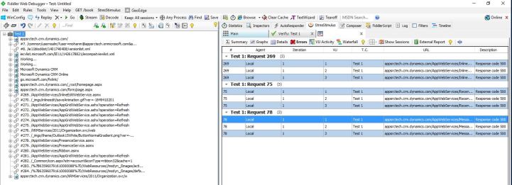

I received Errors.

Your test returns "500" errors in 3 requests. Do you get them when you verify the test case? If yes, then running the test is useless until you resolve the errors (see #6 in my prior response).
As I said, I can resolve the errors in your test on the online support session. I sent you a private scheduling link to our support scheduling app.
