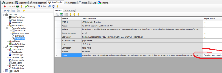

Hi Vadim ,
After our session the other day I am still running into the issue. a freshly recorded script will work for a day  and then will start failing the next day .. I also sent a request to 'support@stimulustechnology.com' on the same.
I was able to trackdown the reason to a security token that needs to be passed from a prior request to a subsequent request .. However am unclear on how to do this thru stress stimulus.
Attached a screen shot below note that the circled payload needs to be extracted from before request
Microsoft.IdentityModel.Tokens.SecurityTokenExpiredException: ID4223: The SamlSecurityToken is rejected because the SamlAssertion.NotOnOrAfter condition is not satisfied. NotOnOrAfter: '1/29/2013 3:51:50 PM' Current time: '1/30/2013 6:33:41 PM'

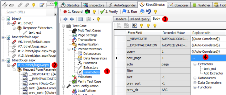

Then, to create a body parameter:
  1. Select Parameter or Navigation Tree.
  2. Select the request on Test Case Tree.
  3. Select the Body tab.
  4. Click in the “Replace with” cell on  the parameter row. Parameterization Control will appear. Expand the Extractors node and select the extractor that you created.
 Depending on your request type, the “Body” tab may look differently, but the concept is the same.
