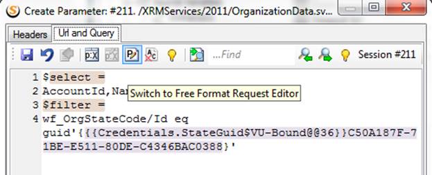

Yes this can be done. To avoid encoding the braces you need to create the parameter in the free format editor (instead of the parameterization editor). Here are the steps:
  • In the test case tree right-click on session 211 and select Create Parameter
  • Select the Url and Query tab
  • Click the switch to free format editor button. Click ok on the StresStimulus alert.
  • In the free format editor create the same parameter the same way as you created the existing parameters.
Your existing parameters will be converted to a new parameter that will not encode braces
