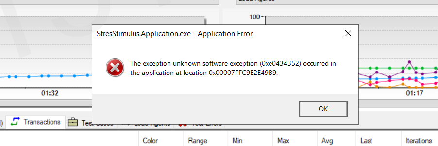

We are getting the below error, and the test is stopped when we are running the Load Test with 200 users, 1 hr duration. Can you please check and support
We understand that this was due to space(memory issue) in C drive and found C drive is full with no free space, but we installed StresStimulus in D drive, so how is C drive full?

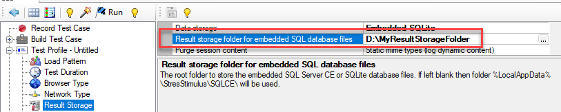

You are probably running out of disk space on your C drive because, by default, the result database files are stored in %localappdata%\StresStimulus\SQLCE, which is typically on the C drive.
To change the result storage folder, set the Result storage folder for embedded SQL database files property as described here https://support.stresstimulus.com/display/doc58/Test+Result+Storage
You may also reduce the database file size by reducing the data stored during the test, as described by https://support.stresstimulus.com/display/doc58/Reducing+Test+Storage+Use.
