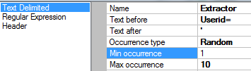

You will need a random extractor that is described https://support.stresstimulus.com/display/doc54/Emulating+Clicks+on+Random+Links
For your situation, create a text delimited extractor with the following properties:
  • Text before: Userid=
  • Text after: ‘
  • Occurrence type: Random
  • Min occurrence: 1
  • Max occurrence: 10
