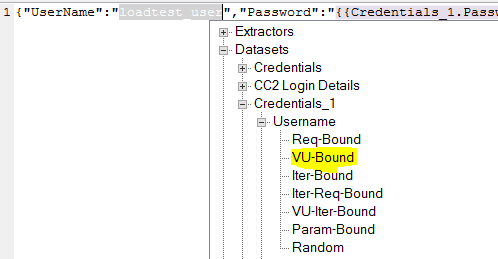

I have another scenario regarding the multiple user login. I have seen the video for multiple logins, where the user details are read from authentication.
As per the video states to parameter the user name and password as Vu-Bound. As shown below
i have done the same in the scripts,But while executing the scripts i could see only the 1st user gets logged in but not the rest users. I tried with VU-Iter-Bound too but still its the same.

Sorry its working fine. You can ignore the above question. Thanks for resolving
