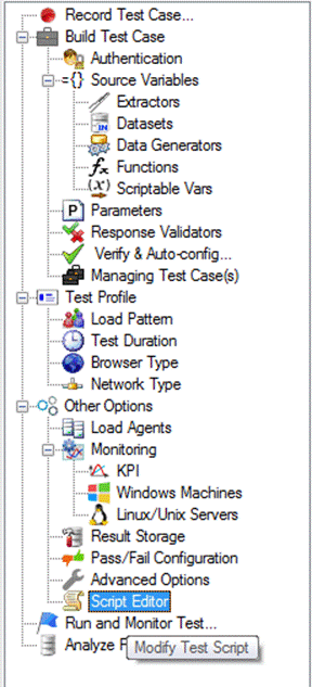

  • Open script editor
  • Navigate to the bottom and copy the entire <Agents> section to the clipboard (or to the notepad)
  • Close script editor
  • Save the test.
  • Open a second test that you wish to copy the agent information to
  • Find the <Agents> and overwrite the entire section with data from the clipboard (or notepad)
  • Click the Save & Exit button to reload the test.
