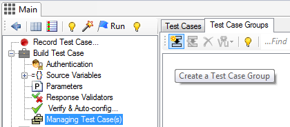

By default, StresStimulus executes all test cases in parallel. It looks like you need to execute some of them sequentially in a certain order. To do so, you need to create test case groups as described https://support.stresstimulus.com/display/doc58/Sequential+Test+Case+Groups
Click the Create a Test Case Group button and add the test cases in the desired order of execution in the dialog.
Then set the mix weights Purchase Order, Approve Purchase Order, Confirm Purchase Order test cases to 0 in the Run and Monitor Test Options dialog as described https://support.stresstimulus.com/display/doc58/Starting+Test
