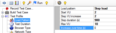

First set the load pattern to step load starting with 2VU and increase by 2 every 900 seconds (15 minutes) until reached 10 the following:

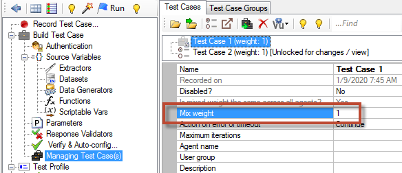

Since you have 2 test cases with the same number of VUs, set the mix weight of both test cases to 1

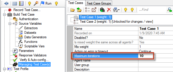

Finally, since you want a maximum of 10 iterations for each test case, set the Maximum iterations property of each test case to 10 as described https://support.stresstimulus.com/display/doc54/Multiple+Test+Cases+Advanced
