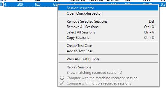

I need to know whether Stress Stimulus is able to capture the application timing, from submit, process, firing request, reaches the interface, reaches the host, come back to application.
2/10/2024
StresStimulus offers complete aggregate and individual metrics for every request in the test without any scripting.
You can see the aggregate request results in the Request details grid in the test report described: https://support.stresstimulus.com/display/doc58/Detail+View and https://support.stresstimulus.com/display/doc57/Request+Details
To see the detailed timers for every individual request:
1. Query the test log to restore the particular requests you wish to view timers for as described https://support.stresstimulus.com/display/doc58/Querying+the+Test+Log
Right-click on each restored request and select the Session Inspector option to open the inspector.
1. Click the Show Sessions Timers button to bring up the timers for the request/response as described https://support.stresstimulus.com/display/doc58/Session+Timers
