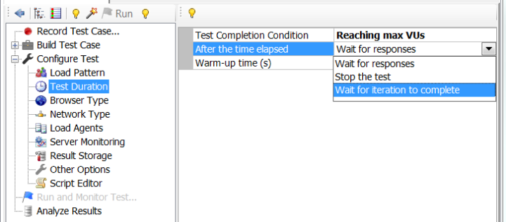

I inspected your. The browser on the summary report is Firefox, as you selected.
There is an issue with your test configuration. You selected the following settings
Test Parameters
Test Case Mix: Test Case 1 (5); Test Case 2 (5); Test Case 3 (5); Test Case 4 (5); Test Case 5 (5); Test Case 6 (5); Test Case 7 (7); Test Case 8 (8)
Description: GLAMS4
Run Name: G4FLOWS
Load pattern: Step load
Start with: 1 user(s)
Increase by: 1 user(s)
Every: 1 second(s)
Maximum: 40 user(s)
Browser Type: Firefox
Network Type: LAN
Complete after: reaching max users
Warm-up time: 10 seconds
According to your settings, the duration of your test will be 40 seconds plus wait time to receive all issued requests (see http://support.stresstimulus.com/display/doc37/Load-Pattern  and  http://support.stresstimulus.com/display/doc37/Reaching+Max+VUs
This time is insufficient because you have 8 test cases included into a Test Case Group for sequential execution (see http://support.stresstimulus.com/display/doc37/Sequential+Test+Case+Groups )
So because of the quick VUs ramp up in your step load, your test stopped before all the test cases were executed.
Here's how to fix it: In the section Test Duration, change parameter After the Time Elapsed from Wait for responses to Wait for iteration to complete (shown below).
Does this make sense?

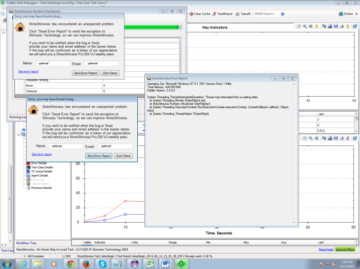

Vadim -
I have done as per your changes, and received 2 errors and there was a promt opened to Send error report, so i have sent those for your reference. Could you have a look on those.

Vadim -
Hi This is the error which i got as per changed you suggested in the above reply.
Kartheeswaran Ramasamy said:
8/13/2014
Hi Kartheeswaran,
Please install the latest version. it will not give you this error.
