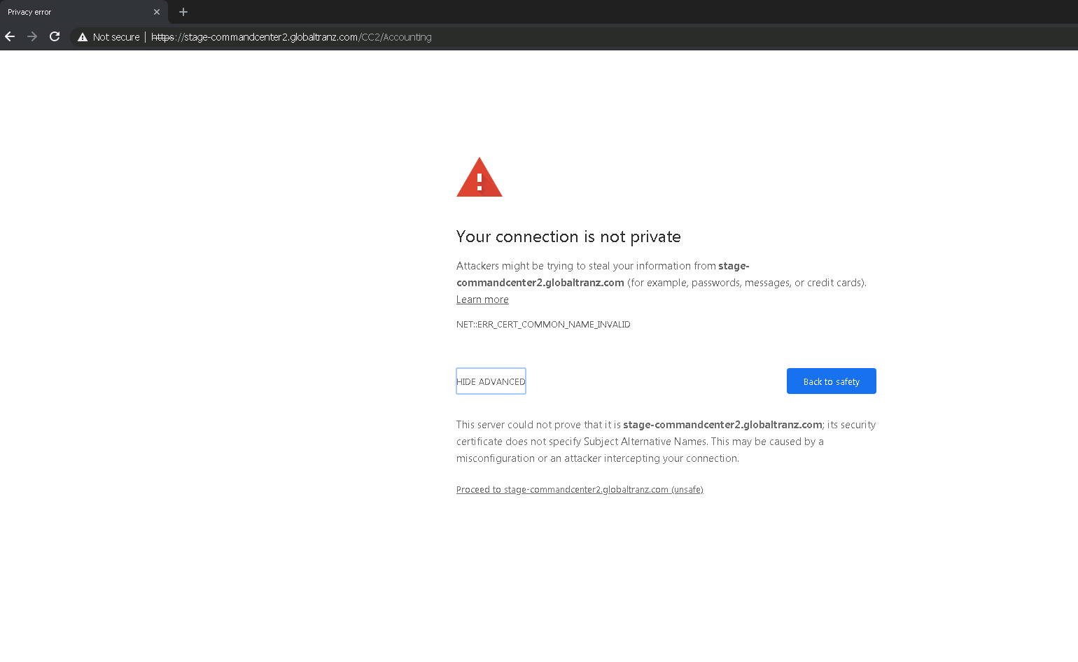

Hi,
I have done below changes
But still when i try to record with the application HTTPS it still shows
I'm recording it using Chrome browser. How can i proceed with it?
Can any 1 help me out.
12/6/2018
It looks like you have a problem with certificate.

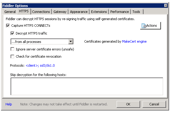

Refer to solution described https://stackoverflow.com/questions/16195469/chrome-doesnt-trust-fiddler-root-certificate
  • Click Tools > Fiddler Options.
  • Click the HTTPS tab.
  • Ensure that the text says Certificates generated by CertEnroll engine.
  • Click Actions > Reset Certificates. This may take a minute.
  • Accept all prompts
In your screenshot your certificates are created by MakeCert, which is not supported by Chrome. Change it to CertEnroll (see the red square outline below).
Also, you might want to consider changing the supported protocols (see the green square outline) as described https://amoghnatu.net/2017/12/04/enable-tls1-1-and-tls-1-2-in-fiddler/

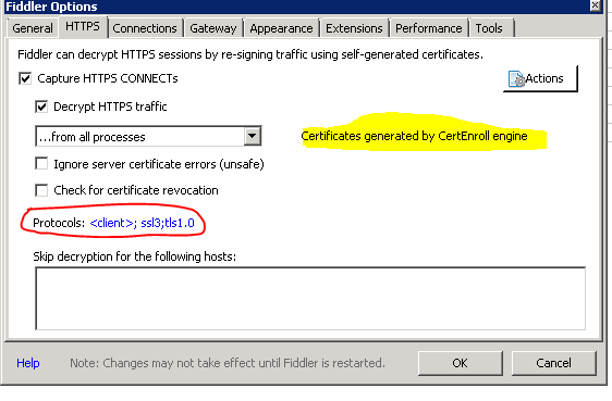

I tried the same by selecting CertEnroll engine as shown below

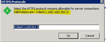

And regarding the Protocols i'm unable to add any other protocols into it as shown below
But still i'm facing the same issue as shown below
12/7/2018
It looks like you might be using Fiddler v2 which does not support Tls 1.1 and 1.2.
Install Fiddler v4 or higher then try adding tls1.1 and 1.2 to the supported HTTPS protocols.
After you do that go Options > HTTPS tab > Click Actions > Reset Certificates (shown below)
Then restart Fiddler.

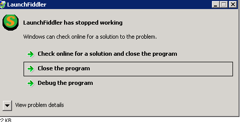

I upgraded the fiddler to version 4 and after upgrading when i tried to launch the Fiddler its throwing the below error
12/11/2018
Can you please try just launching Fiddler and clicking the StresStimulus tab.

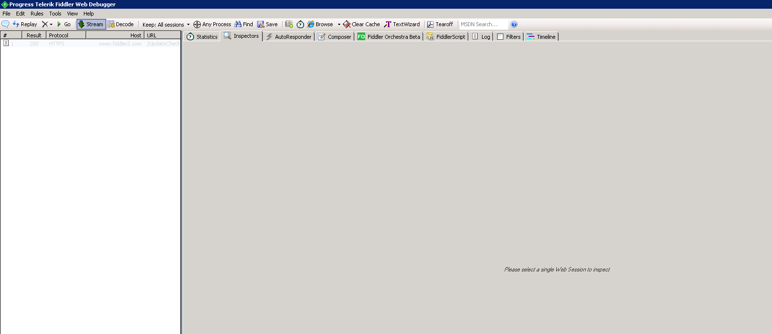

I don see stress stimulus in the fiddler. Attached is the screenshot
12/12/2018
There seems to be a configuration issue on your machine. Please try to install StresStimulus and Fiddler in another environment. Also you can try using standalone version of StresStimulus instead of Fiddler addon.
