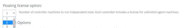

You need only one license, but the type of the license depends whether you need to run concurrent tests or not.
If you do not need to run several tests concurrently, then you can activate a license on one machine which runs the test, while 5 other machines are used as test/script designers ( which do not require serials). You then can move the serial from machine to machine so all of your 6 users can run tests, but not at the same time. In this scenario you need just one single machine license.
If you do need to run let's say 2 tests concurrently, then you can have one floating license with two controllers, which can be activated on two machines at the same time. The cost of the floating license is about 10% more for each additional controller. To determine the exact price, navigate to this page http://www.stresstimulus.com/purchase/order, select a license, and in the shopping cart in the drop-down "Floating license option", select how many controllers you need (see below). The price will adjust automatically.
