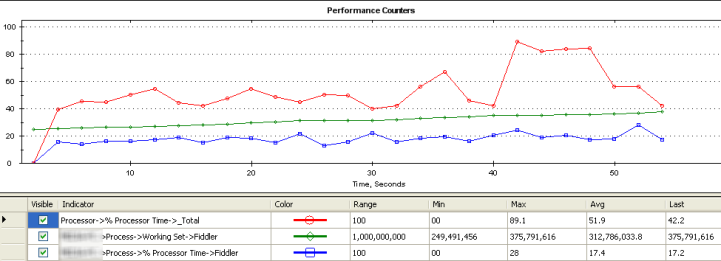

By looking on your graph again I noticed that 55 out of 60 minutes of your test (or 11 out of 12 measurements) the CPU utilization stayed below 80%. The total processor time counter reads an instant (not averaged) value, and the one high reading could be caused by a sporadic spike unrelated to StresStimulus. To better understand was is going on, I suggest doing 2 things: decrease the sample rate from 5 min to let say 30 sec, and add the Fiddler process %CPU counter. Here is the example of Fiddler vs. the entire computer CPU utilization and (unrelated to Fiddler) spikes. This is an indication that there are programs that can be stopped to give StresStimulus more resources.

Predicting a number of VUs that a single machine can handle for a particular test is difficult because it depends on many conditions. To name a few, hardware capacity of the client machine, size of your test case, speed of your web server, and think times. In attempt to increase the number of VUs per machine, the users can consider such measures as using a realistic think times instead of zeros, breaking down test cases (if possible), stopping unnecessary programs, and using the faster machines. However, none of these steps can guarantee that a machine can handle the desired number of the VUs for a particular test. Therefore, the right course of action is to determine through testing how many VUs a machine can handle with CPU utilization not exceeding 85-90%, and based on that and the required number of VUs, calculate how many machines is necessary. 1500 VUs in StresStimulus Pro RC is the capped number of VUs allowed. This number can be reached in some but not all tests. Adding more machines to a load test is common.
If you can send me the test report of those two tests and a new graph with Fiddler CPU use, I can check if I can add anything else to this.
