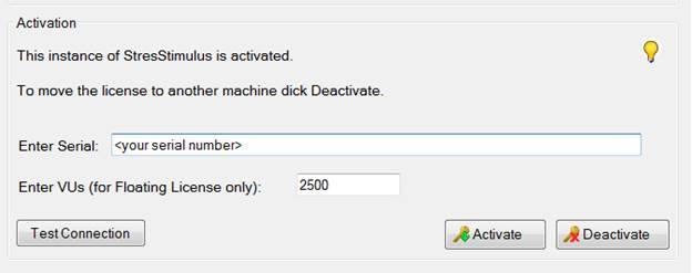

We purchased a floating license with 3 controllers.
Does each of the controllers have its own serial number, or does the single serial number that was sent over handle both controllers?
3/28/2017
The same serial works for both controllers. To activate a controller, enter the serial and the number of Vus from your VU pool that you would like to use on this controller (see below). You can always change the number of Vus and activate again.
Also you are not locked to just three machines. You can deactivate a controller and then activate the serial on a totally different controller machine.
Additionally if you need more hardware capacity for your tests you can attach as many agent machines as you need to every controller, as agents do not require activation.
