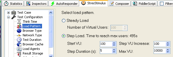

2. Max User Load.
The number of VUs created in the test will not necessarily reach the Max VU settings of the Step Load pattern. The reason for that is the test was not given enough time toramp-up to the Max VU.
Check your settings in the Test Duration section.
For example, on the screenshot below StresStimulus calculated that the test should run for at least 495 seconds to reach 10,000 VUs
If in the Test Duration sections you selected "Run Duration" shorter than 495 seconds, then your test will not have enough time to reach 10,000 VU level. To reach this level, either increase "Run Duration" or select "Reaching Max Users".
