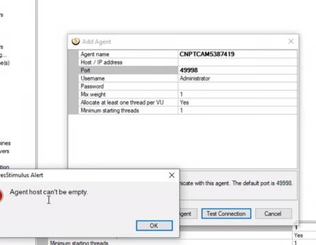

We have questions on “connecting to the agent” machine:
  • Is “Agent Name” the agent name on the Agent machine, as given in “Agent Options”?
  • Is IP address to be taken from Agent Machine (by ipconfig command?)
  • What should username / Password be?
2/4/2021

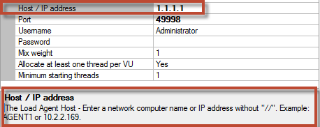

The “Agent Name” is the name that you give. StresStimulus will use it for reporting purposes.
Host/IP is the Network hostname or the IP Address that the controller machine will communicate with the load gent machine. So it can be the agent name on the Agent machine, as given in “Agent Options.” It also could be the IP address from the Agent Machine ipconfig command.
The Username/Password is the username and password of a user account of the load agent machine. It is recommended to use an administrator account.
FYI: In StresStimulus, all properties from the property grid are described on the description line below when you select this property.
